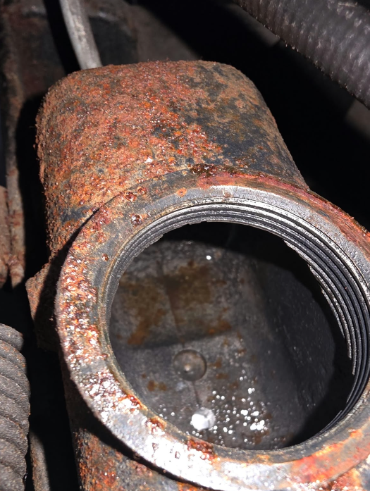

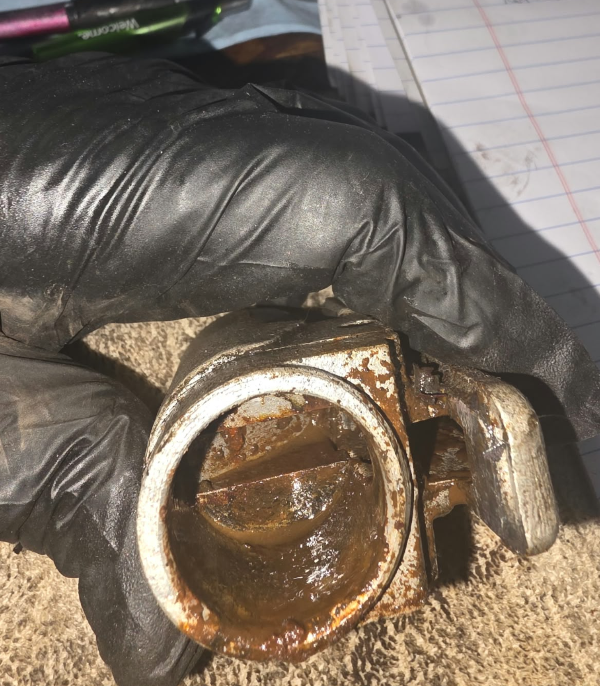

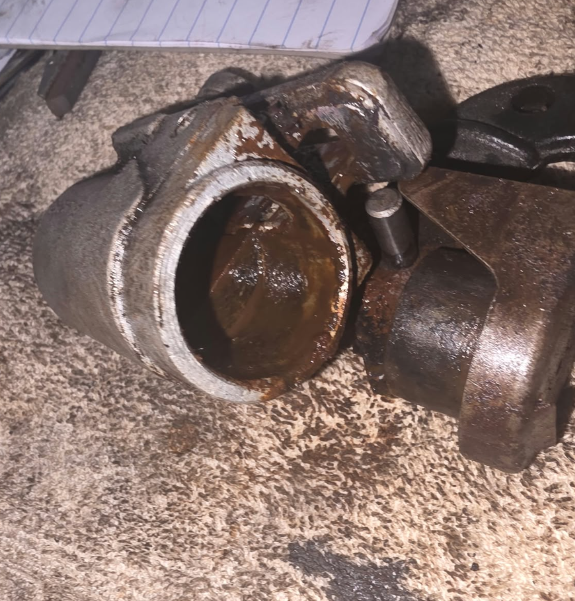

Ben StevensKeymasterWhen we drove the Allard this morning, the brakes were horrible and not working. We got back to our shop and it had ZERO brake fluid in the system-see attached. So the car had no brakes, and no emergency brake. We filled up the system and bled it, and both rear wheel cylinders were leaking
We are rebuilding the wheel cylinders.
The transmission is leaking from the front pump seal. Does anyone have a part # or know where to order it from?
Also a transmission coupler joint seal is leaking. Is anyone able to assist with auto transmission pump/seal for 1953 K3?

The condition of your brake cylinders is the result of water being absorbed by the brake fluid and the passage of time resulting in the condition that you find. The pistons in the cylinders are steel, the bodies are Aluminium and the result is corrosion when water is absorbed. If the bodies of the cylinders are in good order and you are going to rebuild them I would advise you to get them sleeved with a stainless steel liner.
You can get reproduction parts to get you up and going more quickly but be aware they do tend to leak, I am going through the same thing at the moment. I replaced the two rear cylinders in March this year, the previous ones only lasted 18 months before leaking.
I just discovered one replaced in March this year with about 400 miles on it leaking and fluid all over the back wheel. this is why I suggest getting them sleeved if you can. The master cylinder is cast iron I believe and can corrode for the same reason and can also be sleeved if it is in bad condition.
I replaced my master cylinder over ten years ago and is still in good order with no leaking, it just appears to be the cylinders that are a problem.
