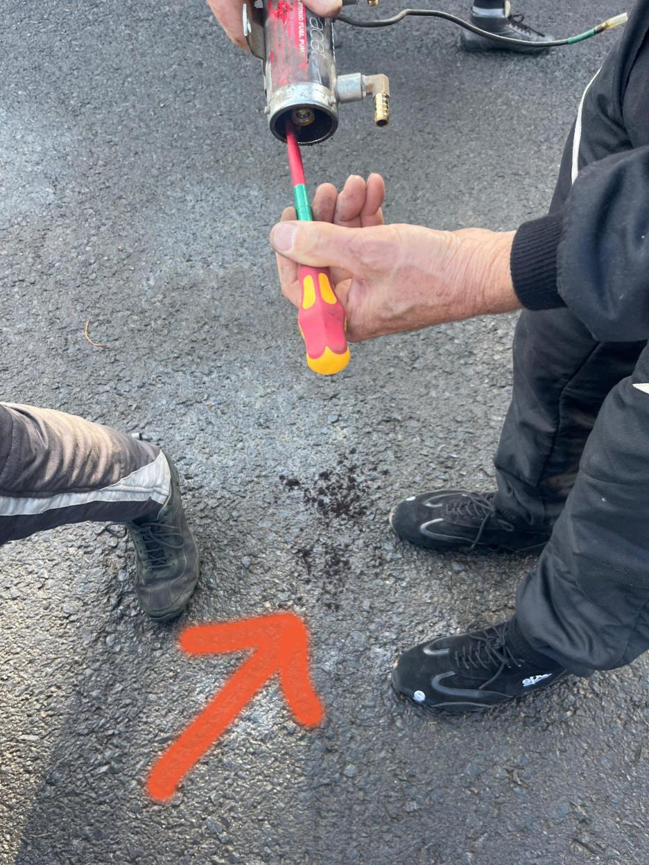

13 February 2026 at 9:05 AM #11916
Ben StevensKeymasterIt’s true… here’s a picture showing what happens if you don’t fit a filter BEFORE your fuel pump
